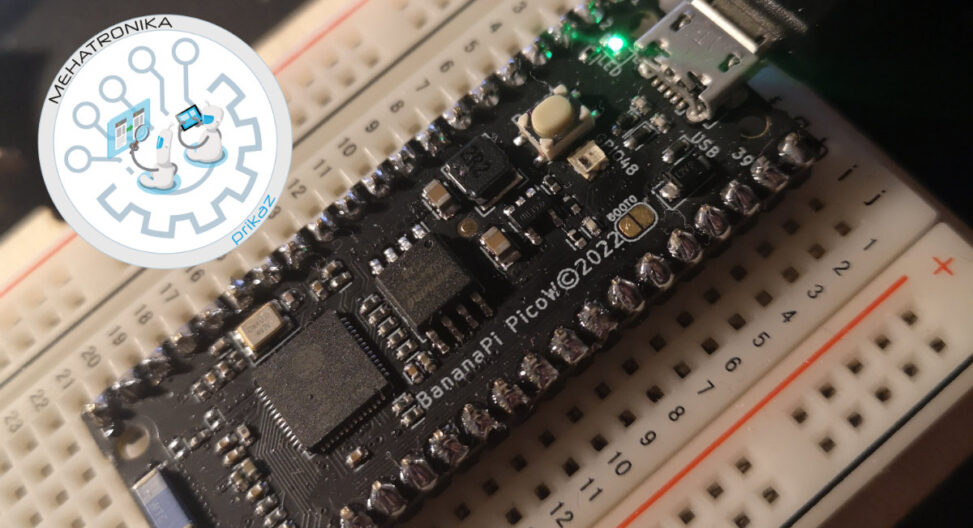

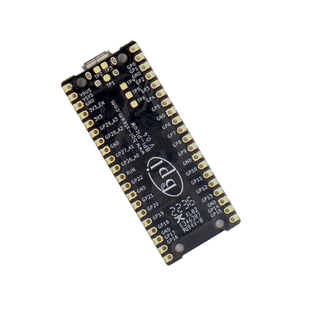

BPi-PicoW-S3 topview BPi-PicoW-S3 bottom view
CircuitPython is pre-loaded on the board is geared towards STEM projects. All Adafruit ESP32-S3 Feather examples worked perfectly – with potential small changes of GPIO pin numbers. Standard WiFi connection examples also worked perfectly first try – so its safe to say that the board is fully compliant.
BPi-PicoW-S3 box
Arduino IDE support is also good – with generic ESP32-S3 libraries handling everything – as there are no custom libraries for the PicoW available yet. The most complicated, but most fully-featured option is the Espressif IDF package – which offers low-level access to the system at hand.
